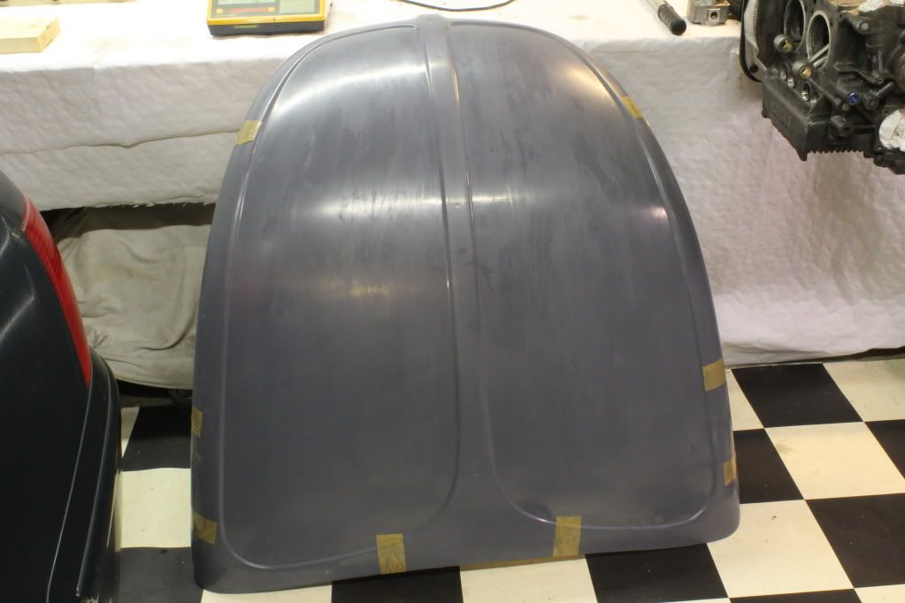

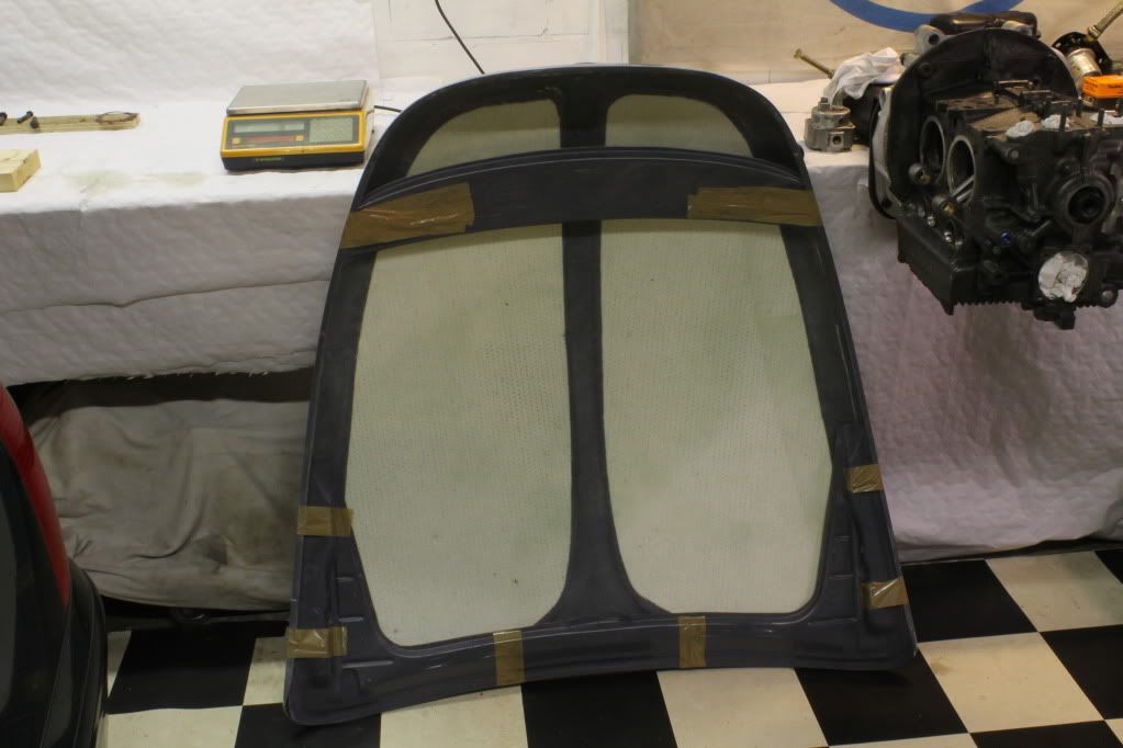

I also got a glassfiber front bonnet from Kerscher. Its 3 pieces that I am glueing together as we speak. Almost 4kg lighter then the original steel part:

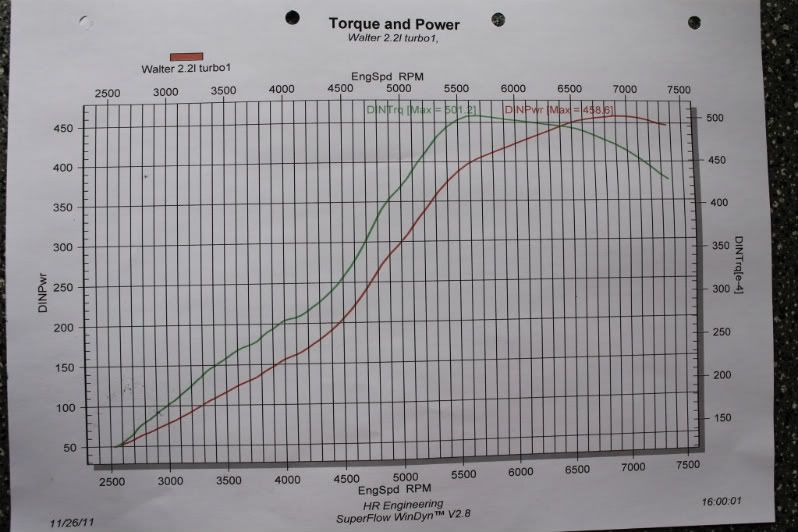

After this season we dyno'd the engine again and she still made almost exactly the same 460hp as at the start of the season:

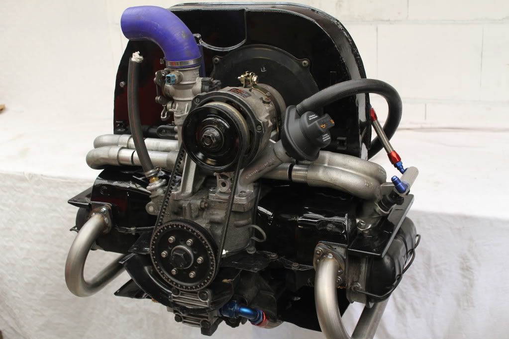

1208cc (77,5x64) long block ready 8)

The 1200i is almost complete now and the type 4 is already out of the car :scratch:

is this the CB dry sump pump that I see?
Are you happy with this?
What do you use on the type 4?

Xav a écrit :Hi
Yes, CB Schadeck pump; yes, happy with it as I used to run one on my former 412S with 2.0 T4 engine.
On the 2,2turbo T4 I use a Thorsten Pieper dry-sump pump: much better quality and even better performance :wink:

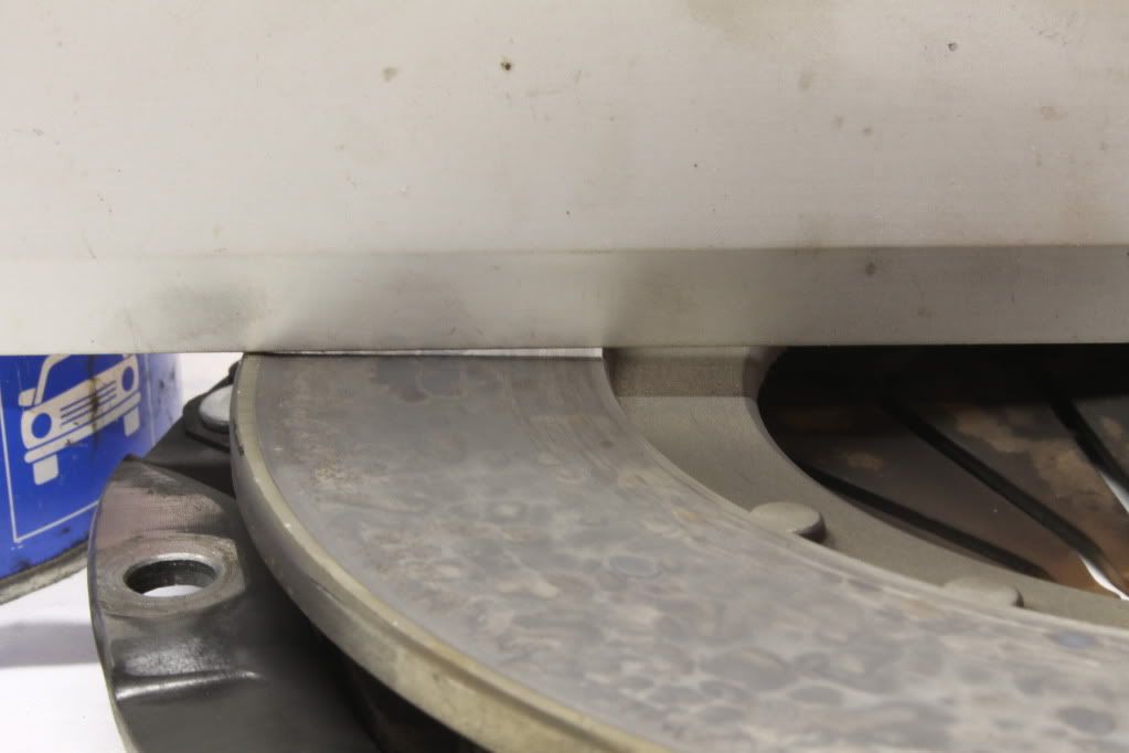

This is how the pressure plate looked from the 2,2T4T (twin black magic disks in 228mm size...)
That looks bad :(

Superflo a écrit : That looks bad :(
According to the americans and Marty Staggs, this can be machined flat again. First usage giving the most warpage, shouldn't be too bad after that :-D
