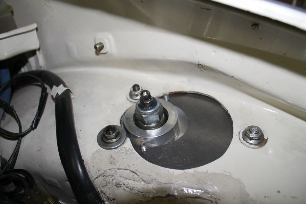

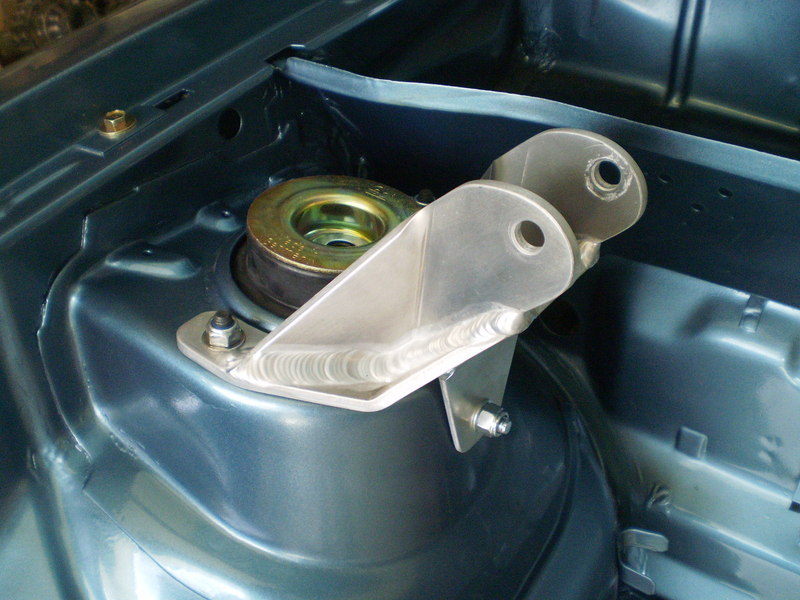

Alors, just in time for Spa-francorchamp, installed a adjustable caster top strut bearing holder (what a word!):
Its for better straightline stability. Also had an alignment job today done and some ventilation sleeves also in the rear fenders (come and see them in Spa), so car is ready :-D
You don't run a strut bar between the shock towers?

Superflo a écrit :You don't run a strut bar between the shock towers?
I DO run a strut bar, but its just a little lower in the picture (not visible here) and located and welded between the towers itself, just not mounted to the M8 bolts of the strut itself :wink:
Come see for yourself this weekend?
Re: 1303 Mythbuster -> 2,2 ltr T4Turbo version 2.0

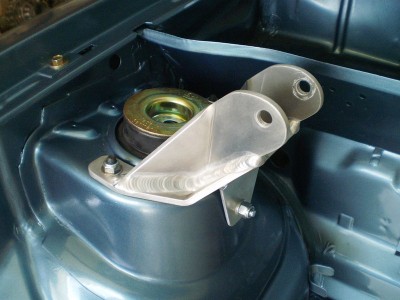

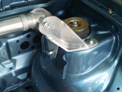

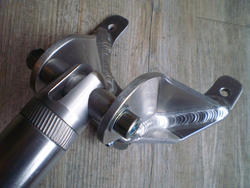

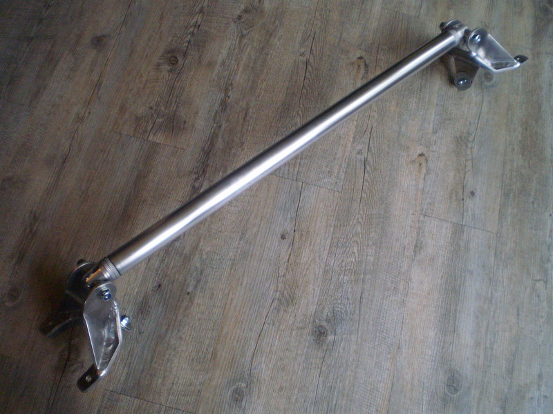

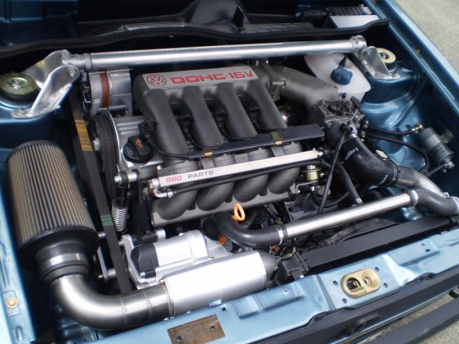

this heigo strut bar is for vw golf1 but look very nice :P

Alex a écrit :this heigo strut bar is for vw golf1 but look very nice :P
Yes, but I see that design as mostly for looks indeed... Its too high for my taste, which reintroduces new bending force. He also still runs rubber top strut mounts...
