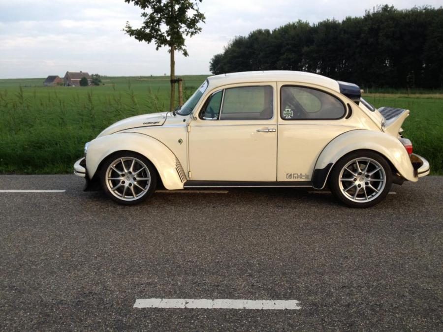

Walter, you find a changement of stability and speed ? I'm surprise of this pict but the resarch want this.
