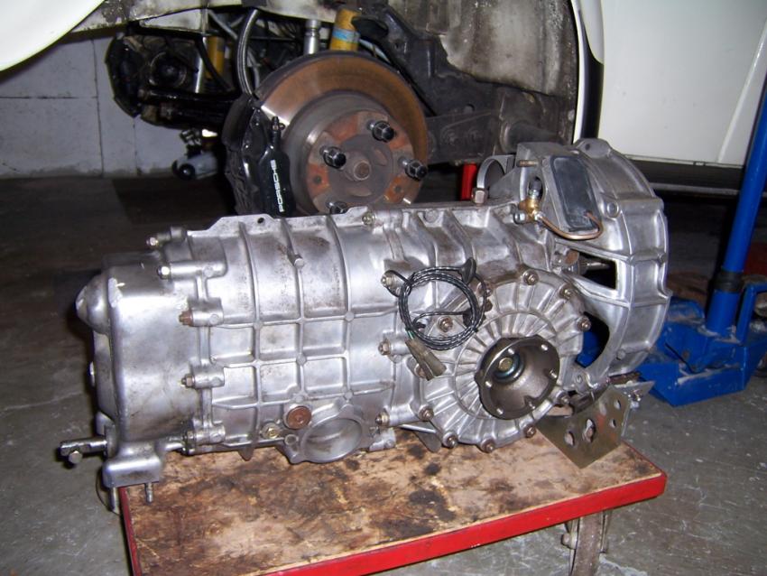

Since I fear that this next 2,2 turbo engine will make a lot of torque (too much for the 915 maybe), I am trying to install an early short-nose G50 tranny in place of the 915.
Trial fitting G50 to type 4 casing:
I want to shorten the bellhousing and main shaft by 28mm, so the entire G50 transmission has to be taken apart...

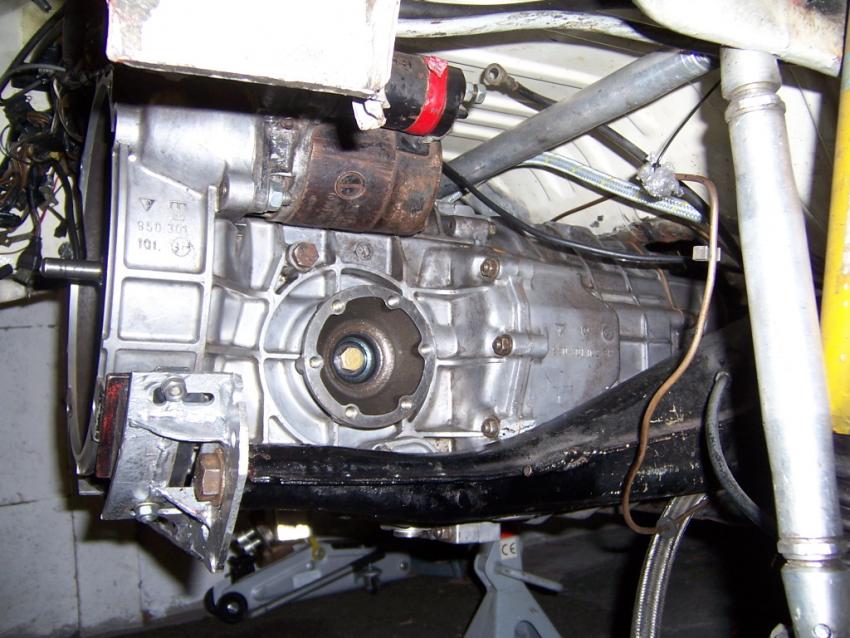

Test fitment de G50:

Transmission is back together:
And it now fits perfectly in the car
