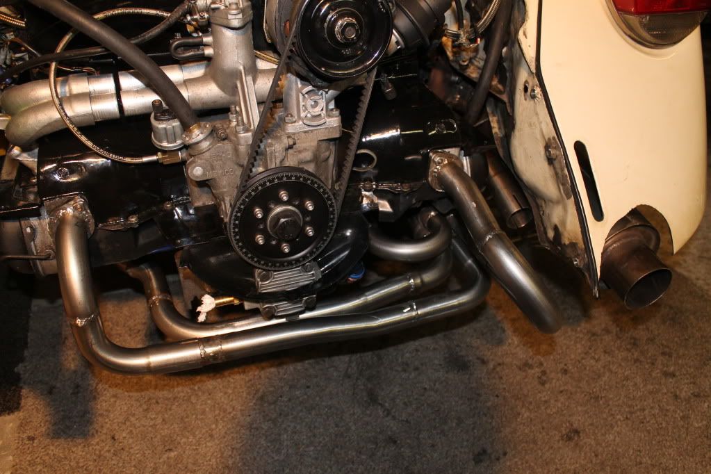

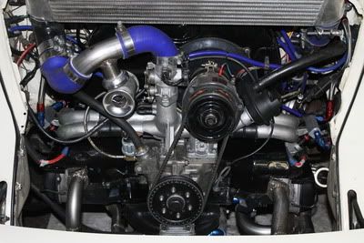

1208cc type 1 turbo EFI dans le assemblage 8)

Message par Airspeed »
Motor finished and she has run! Yahoe!
Maintainant beaucoup de 'mapping'/tuning :wink:
Re: 1303 Mythbuster -> 1200cc T1T Challenger
just perfect, a beautiful horsepower factory :thumb:

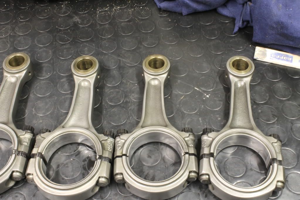

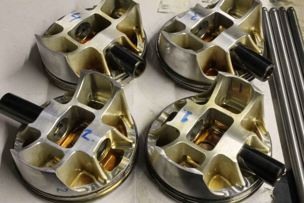

This weekend I disassembled the 2,2 T4 engine as I wanted to change the cam for this season.
Heads, Pistons, cylinders, bearings, crank, all looked great!
Pistons:

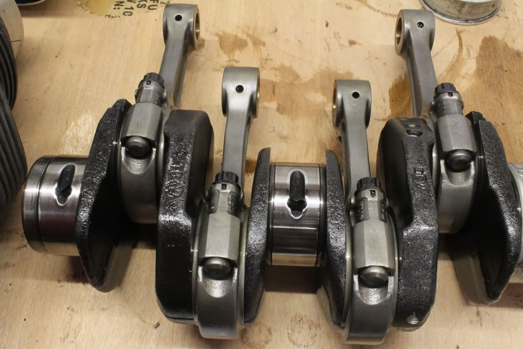

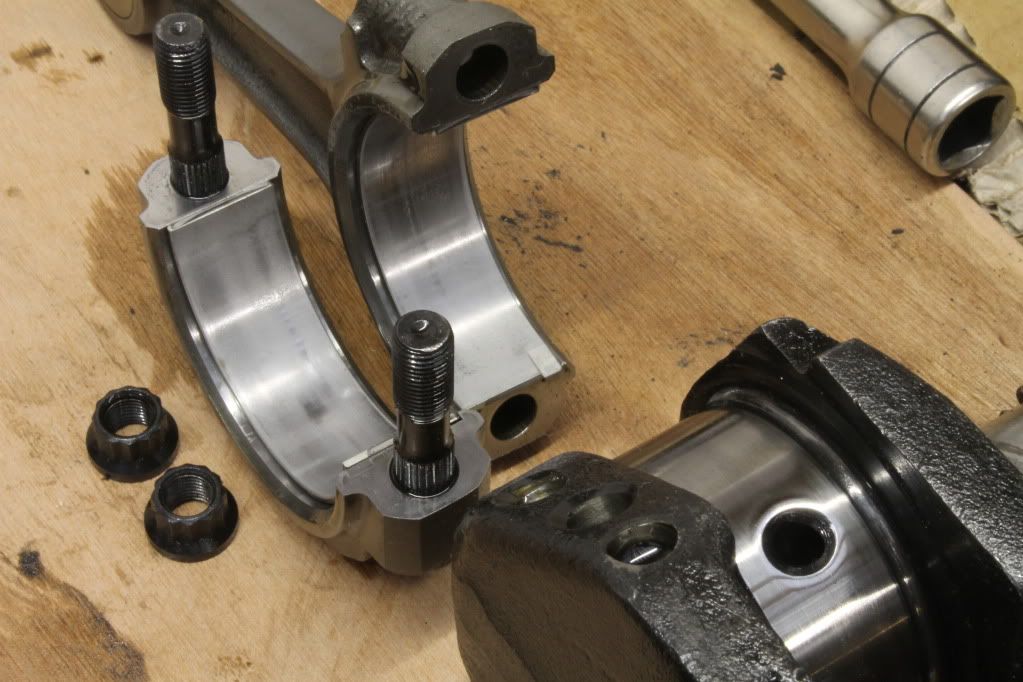

Unfortuneately, it turned out that one rod is bend! :( Look at the second rod from the left:

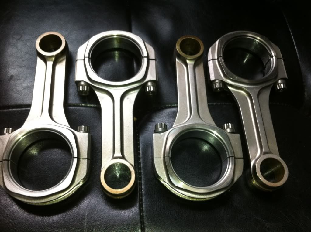

Anybody have a set of (used) Pauter rods for a 1,7ltr T4 crank I can take over? :roll:
I think you reached the stock rods limits!
Did you notice something when the engine was runing with the bend rod?
Superflo a écrit :I think you reached the stock rods limits!
I think it was because of boost-cut and heavy back-fires that caused this.
Stock rods can easily hold 500Nm, even more I think. Not big explosions from rpm limits and/or hard-cuts (fuel cut) on top of that.
Actually turned out 3 rods were bend...
No, not really. I had expected a little more power, so the piston not being straight in the bore must have been a problem, loosing some compression probably.
Fortunatly I found some Pauter rods as replacement :mrgreen:

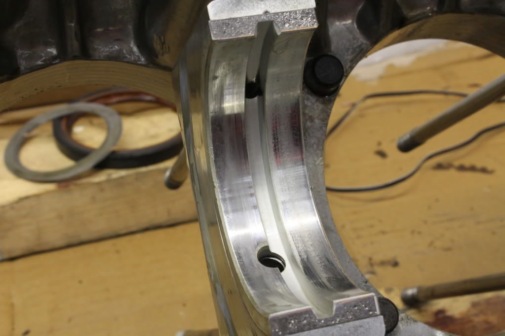

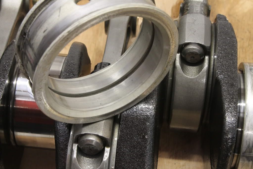

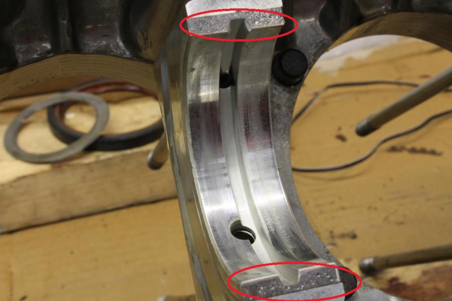

Crankshaft is spotless and must be straight as all main and bearings were super nice as well:
I noticed this kind of "pitting" on my 2.4L engine, I assumed it was caused by harmonics due to a non-balanced trigger wheel, why do you think?
