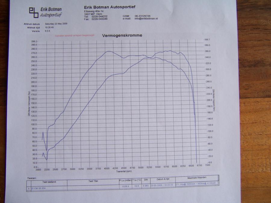

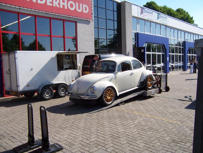

Tnx, I did dyno it on a mobile dyno the other day, but the conditions were not ideal and results were a bit diappointing: the were about the same as with the 2 ltr engine.
http://www.youtube.com/watch?v=kOYaWh5hFSk
Dynorun itself:
http://www.youtube.com/watch?v=xSoyPv_QhNo

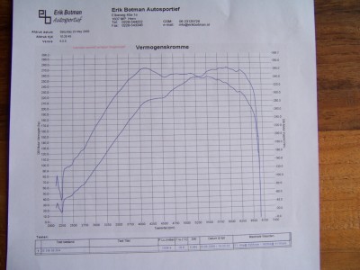

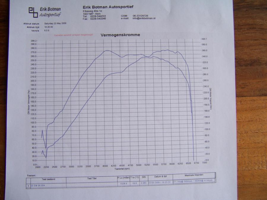

Flywheel power/torque graph at 14,5 psi or 1.0 bar boost:
I have since then tuned the engine a bit more and also made a little better intake. In two weeks time (june 21) the engine will be at that same mobile dyno again, so I hope my tuning made a difference.

Torque 350 Nm ! That would suit me very very well !
Now I understand better the way it revs up in last gear !
