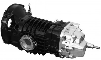

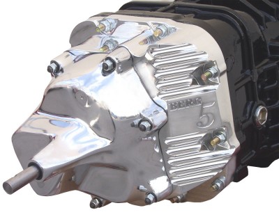

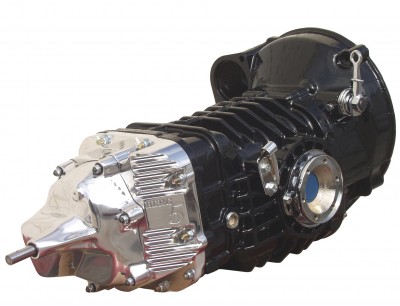

je commence a regarder les boites 5 pour bus, j'ai contacté Rancho et j'ai recu pour l'instant que des photos
Je posterai ici les infos que j'aurais, ca pourra servir à l'avenir pour les proprio de bus ( ou de cox).
Voir si c'est une alternative interressante aux boites Porsche, prix? le point plus c'est deja le plug and play :wink:
Apparemment ils greffent un kit 5 Berg, j'attends des infos sur les rapports.

C'est de la belle pièce en tout cas!

The only one available is my own personal Trans it has a 4.86 R/P 1-5 Gears 3.44- 2.08- 1.48- 1.13- .77
it has a ZF Diff. The Trans was made with some Berg Parts but the Housing is LAND Products.
Gearing is for 26 inch. tall Tire, 200 HP and a 1900 LB Car.
I have been working with them to develop our own Type 1 and Type 2 5-Speed Kits.
The Trans Case can be 002-091 or the Pyramid Case like in the picture. They are based on 002
Gears.
I am asking $6000 for mine out right. The one in the picture had a Super Diff.
