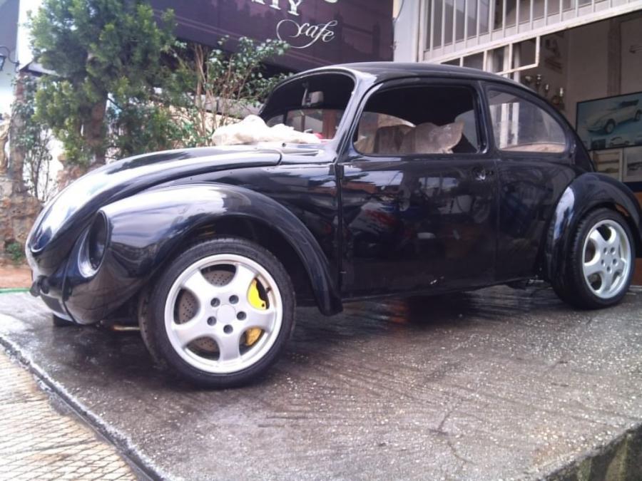

--Body Exterior--
New wings (not modified or bigger)
New running boards painted "Carbon Fiber effect"
New front & rear Bumper painted "Carbon Fiber effect"
Front Headlight rims painted "Carbon Fiber effect"
New HELLA Lights front & rear & white turn signals

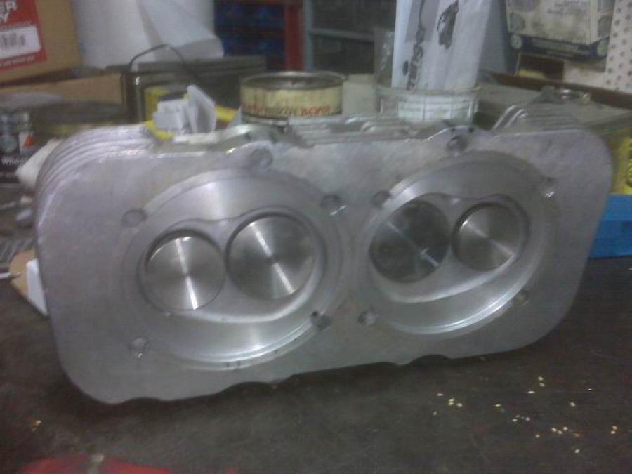

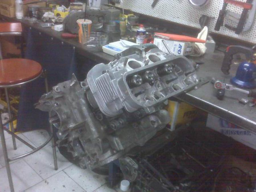

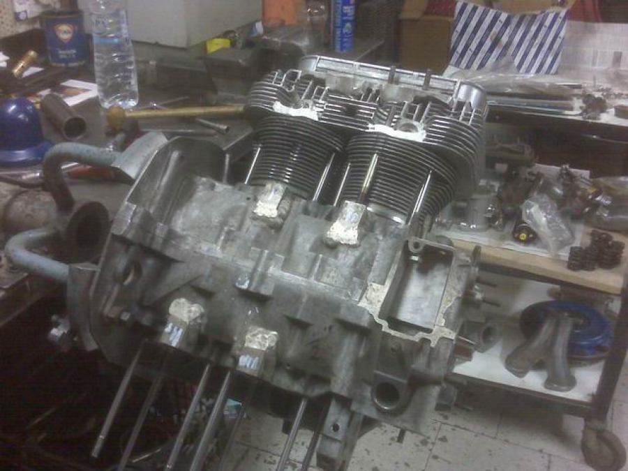

Type IV highly modified crankcase (PORSCHE 914/4-injection) bored to 103mm with ARP 2000 stud kit
SCAT billet chromoly crank 80mm with Chevy rod journal
PAUTER con rods with 3/8 ARP bolts set
JE 103mm piston set + Total seal rings
New 103mm iron cylinders

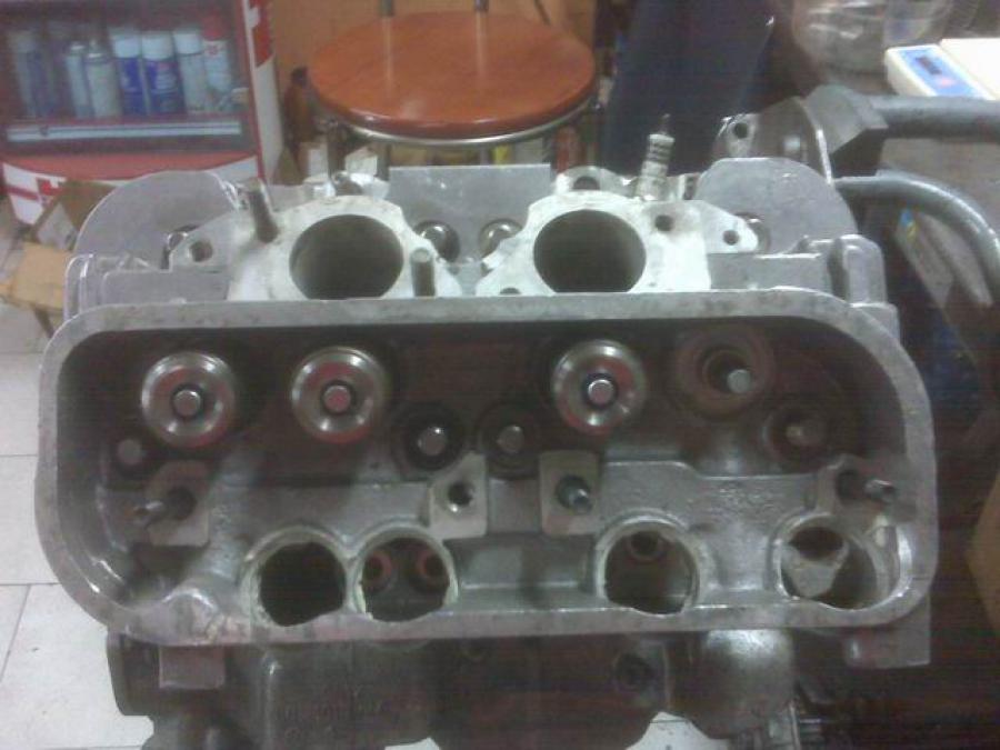

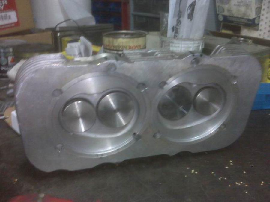

Highly modified Type IV cylinder heads inlet valves 50mm, exhaust valves 42 mm, compression ratio set @ 11.9:1 -

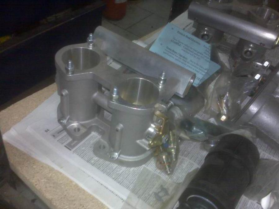

Weber ALPHA 48mm throttle bodies
HALTECH ECU - http://www.extreme-tuners.com/

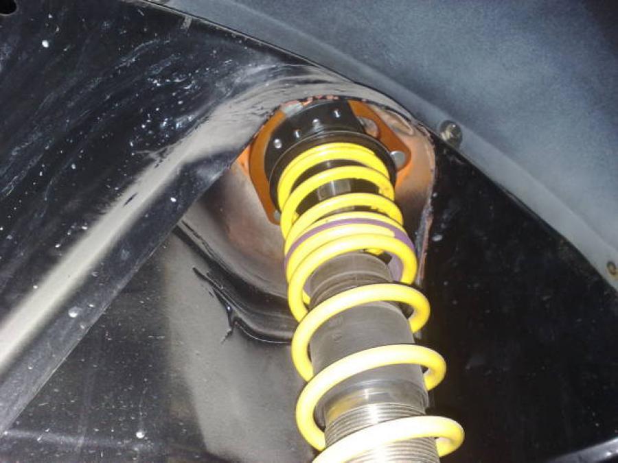

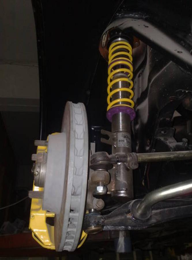

KW variant inox line coilovers all around

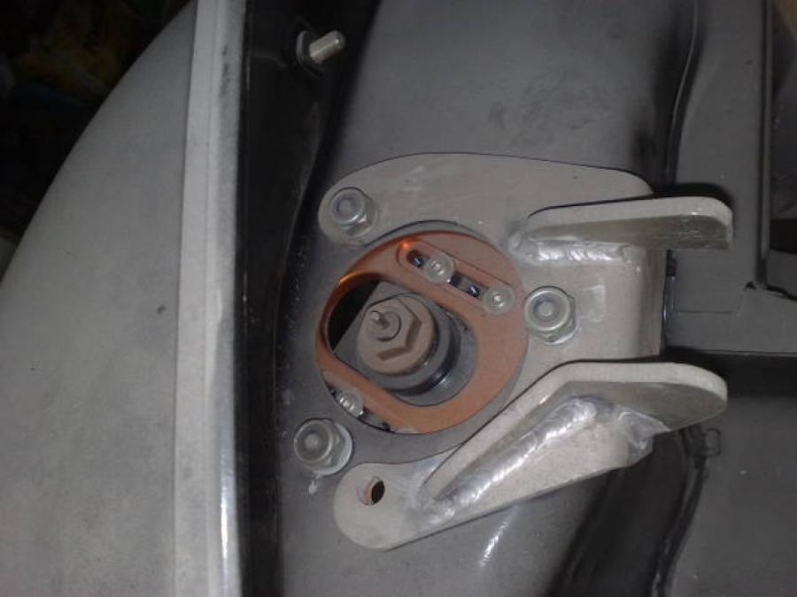

Front adjustable top mounts

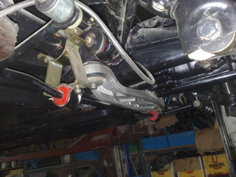

GWD rear uni ball system

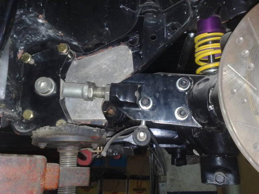

PORSCHE 944 turbo suspension arms
VW 1303 super beetle front lower arms
BILSTEIN steering damper
KERSCHER aluminium front + back anti roll bar
Aluminium Cub brace / torque bar
Aluminium Front strut brace

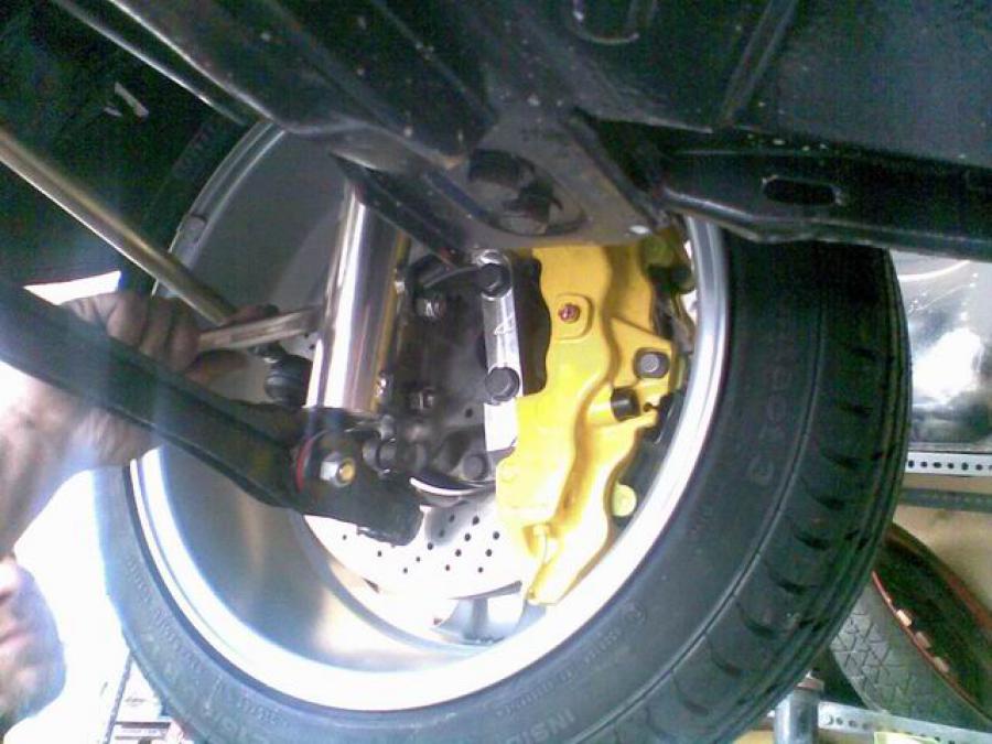

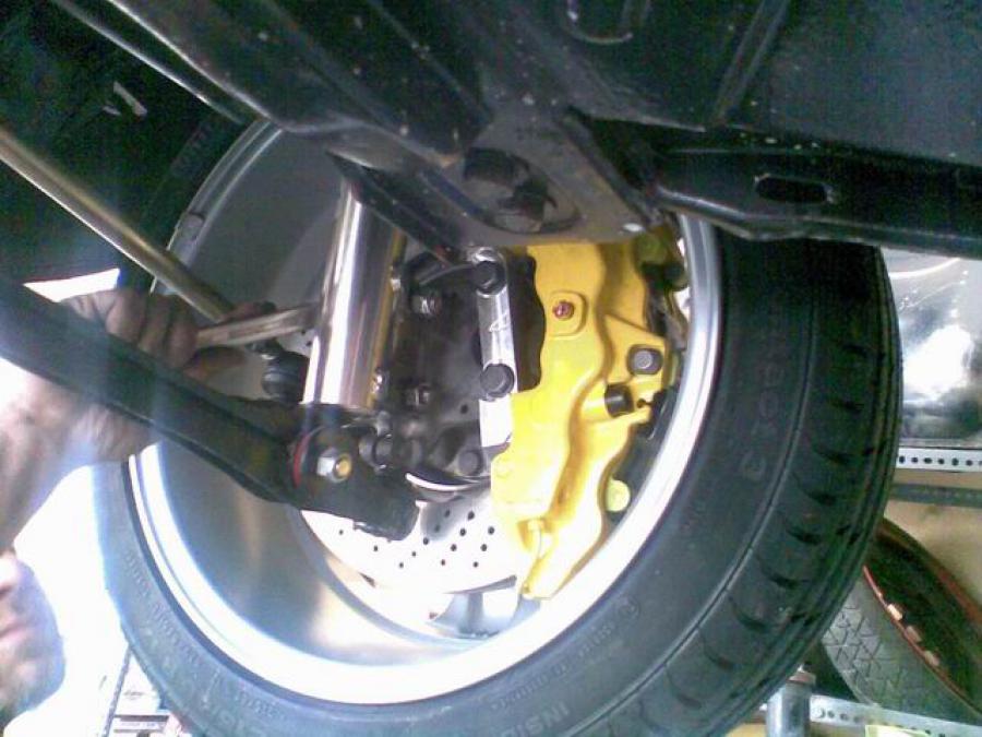

PORSCHE 996 gt2 6 pot front brakes with new discs
PORSCHE 964 Carrera 4 - 4 pot rear brakes with new discs

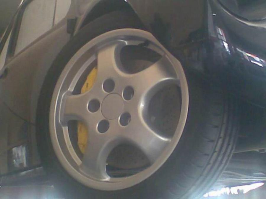

PORSCHE 911 Cup I - 7,5 x 17 "dressed" with brand new Continental tires

Top quality parts gathered into a top GL 1302SB

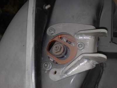

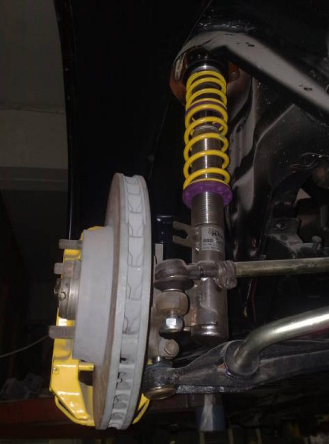

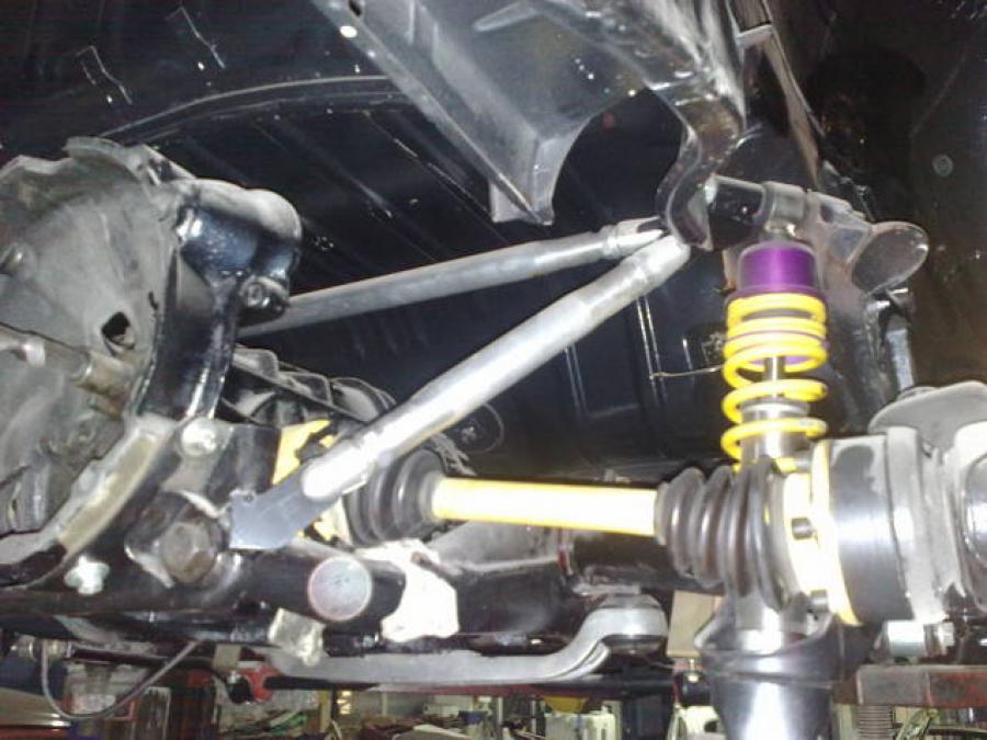

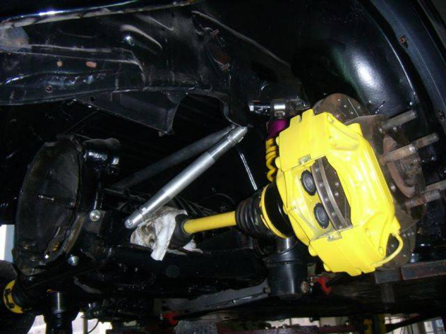

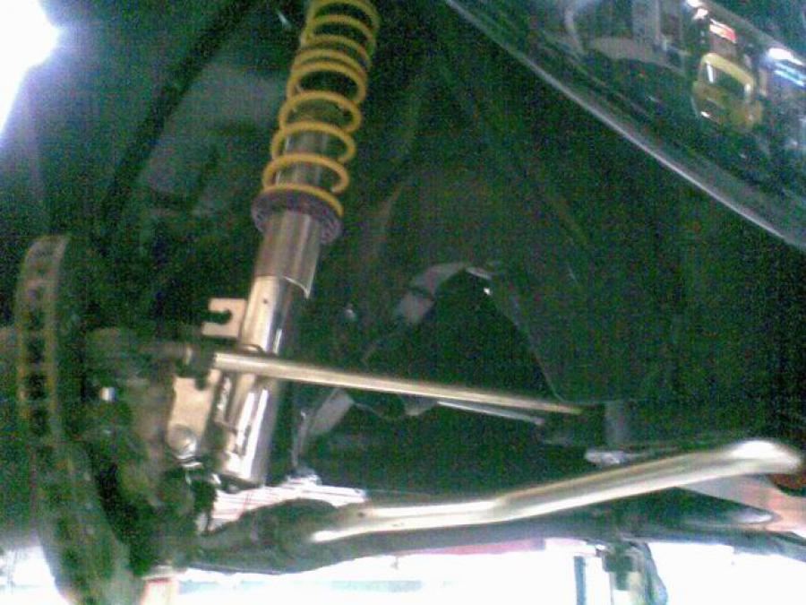

Have you lowered the front axle ? I wonder if you face bump steer issue with your front setup ( Kw coilover / 1303 suspension arm / anti-roll bar / 1303 disc spindle ?)

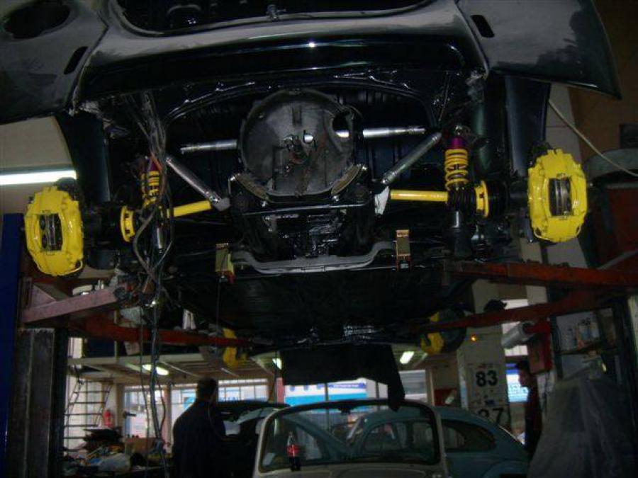

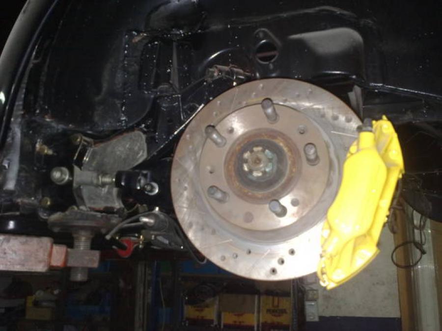

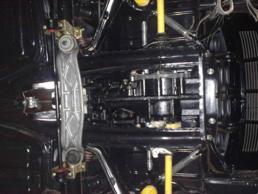

Thanks a lot for the welcome, I wouldn't know. The car is not totally finished. Hopefully within 2013 (big crisis over here)
-Bodywork has finished – everything painted & fitted on the car.
-Interior has finished with all gauges in place. Red leather on the dashboard, black headlining fitted, red carpeting is all in place (Front, rear seats & side cards have not been finished but I have bought the leather to re-upholster them)
-Suspension has finished and has been fitted on the car needs to be tuned though
-Brakes have finished including handbrake (hydraulic) and have been fitted on the car
-Alloys & tires ready on the car
-901 dogleg gearbox has been rebuilt with a Quaife LSD and has been fitted on the car, gearstick ready & fitted
-Engine short block, heads, etc have been assembled but not fitted on the car yet (Engine is currently sitting on the bench). We have not fitted the throttle bodies & the ECU. The idea was to originally run the engine for the first 5000km on carbs and then place the ecu with the throttle bodies in order to program them on the dyno. New wiring loom needs to be done. 911 fan has not been fitted, Dry Sump has not been fitted; oil radiator has not been fitted, Oil lines have not been fitted, Oil breather box has not been fitted, Exhaust system has not been fitted.

Do you have the feature to run in closed loop lambda contol with your ecu? I use this with my DTA S60 to get a quick base map.
