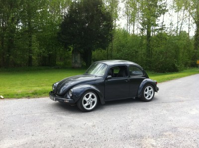

PETITE PHOTO APRÈS REMONTAGE. ENCORE QUELQUE BRICOLES MAIS CA COMMENCE A RESSEMBLER A UNE VOITURE. :wink:
CA TOURNE PLUTÔT BIEN.
AU NIVEAU DE LA BOITE J'AI MIS DE LA TOTAL 75/80. JE NE SAIS PAS CE QUI ÉTAIT PRÉCONISÉ POUR LES BV PORSCHE 901.
ET MA MARCHE AR SIFFLE A MORT !!
J'IMAGINAIS UNE 5EME PLUS LONGUE. A 100 AU GPS JE SUIS A 3200 T/MIN.
