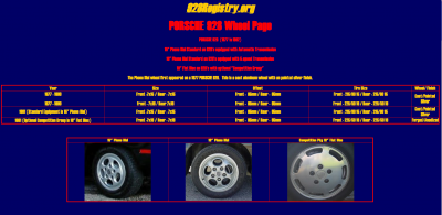

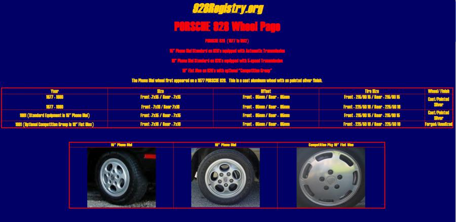

Merci à tous pour vos recherches.928.361.016.00 is 7x16" ET65 like all 7" 928 wheels. Unlike 944 and 911, offsets in 928 didn't change. There aren't old and new offset wheels for 928. They are all just 928 wheels and will work in all model years as long as they fit on top of brake caliper used in each model.
http://www.928registry.org/928-wheels.htm
ET65
