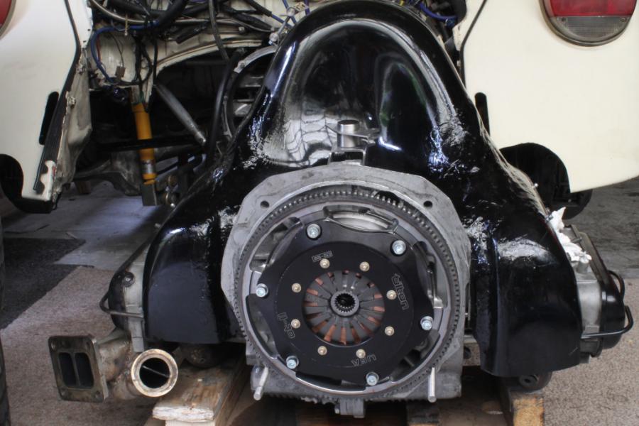

Just finished the cooling shroud for the long block and awaiting the lightened flywheel this weekend.
First had to cut it in 3 parts to shorten it (engine is very small/short):

What kind of clutch setup are you going to use on the type4 engine?
Airspeed
Messages : 324
Moteur : 2,4 T4T
Localisation : Pays-bas
Re: 1303 Mythbuster -> 1200cc T1T Challenger
Message par Airspeed »
Its will be a Tilton cera-metallic dual disk set-up in 7,25" diameter (184mm).
I'll make a pic when clutch and flywheel are back here. It should be very light-weight too (both flywheel and clutch) :wink:
Cooling shroud is 'repaired' :lol:
